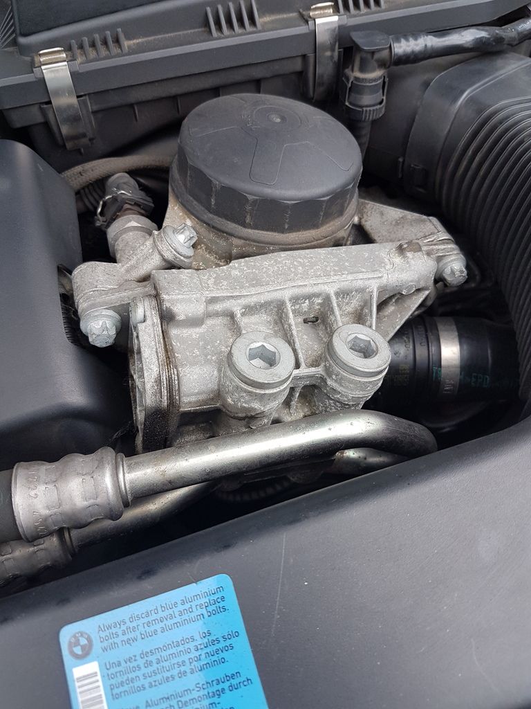

There is no obvious sign of leaks ( nothing on the undercarriage) ...... nothing obvious around the rocker/valve cover..... a little dirty oil on the front of the engine and around the oil filter housing..... the spongy material under the engine cover seems to hold quite a bit of oil so maybe oil filler cap is at fault ???

Without looking at the car, some of the old engines in mean, the old 328 or 318 the gaskets for the oil filter goes might be an idea to looking around this area

The fact you have a smell of burnt oil and nothing underneath suggests a leak towards the top of the engine. The oil filter casing is a known weak point - it's plastic so can go brittle and crack if over-tightened - this is of course a service (related!) item as the filter will be replaced. Oil filler cap is unlikely as they're not tightened up, but would be obvious as the sound-proofing immediately above it would be soaked and the engine would run badly due to lost crankcase pressure. Valve cover is a possibility, but should be visible. Inlet mani should have no relation to the engine oil at all!!

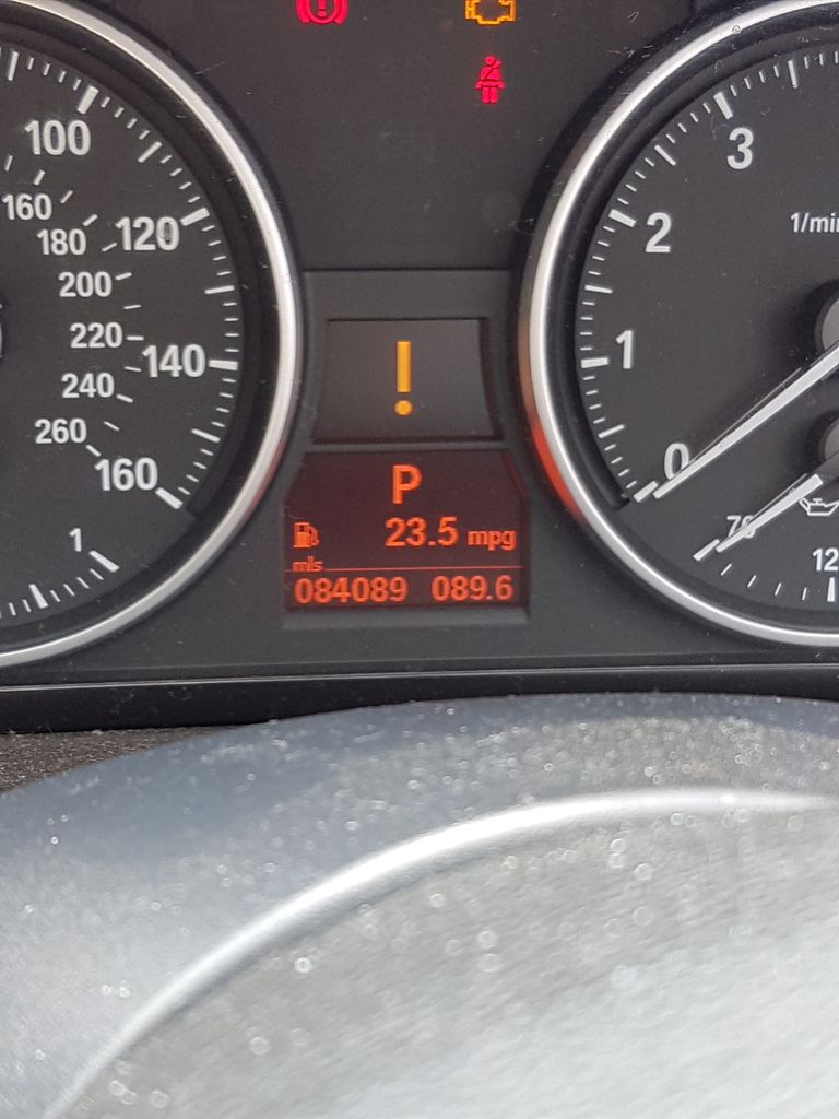

You are correct regarding the dash level sensor taking ages..... today.. first day back at work I did it again and low and behold..
So it hasn't lost quite as much as I'd thought but it is losing it.....

Ok, just for reference the car asked for a 1lt top up today
Just over 84k so lets see how long it takes.... although I am just coming up to a service in 1500 miles which is sure to throw a spanner in the works.... i may buy a new oil filter cap to eliminate it... looks ok though to be fair.
The area around the filter housing doesn't look perfect so I may just replace the housing gasket, although I have heard one of these bolts are a real pain due to the inlet manifold
Posts: 23407
Re: E92 335i oil consumption
Post by M60NJP » 24 Jun 2017, 16:01
Looks fine and dry - but they're fairly cheap (non-OEM) so np harm in replacing.
